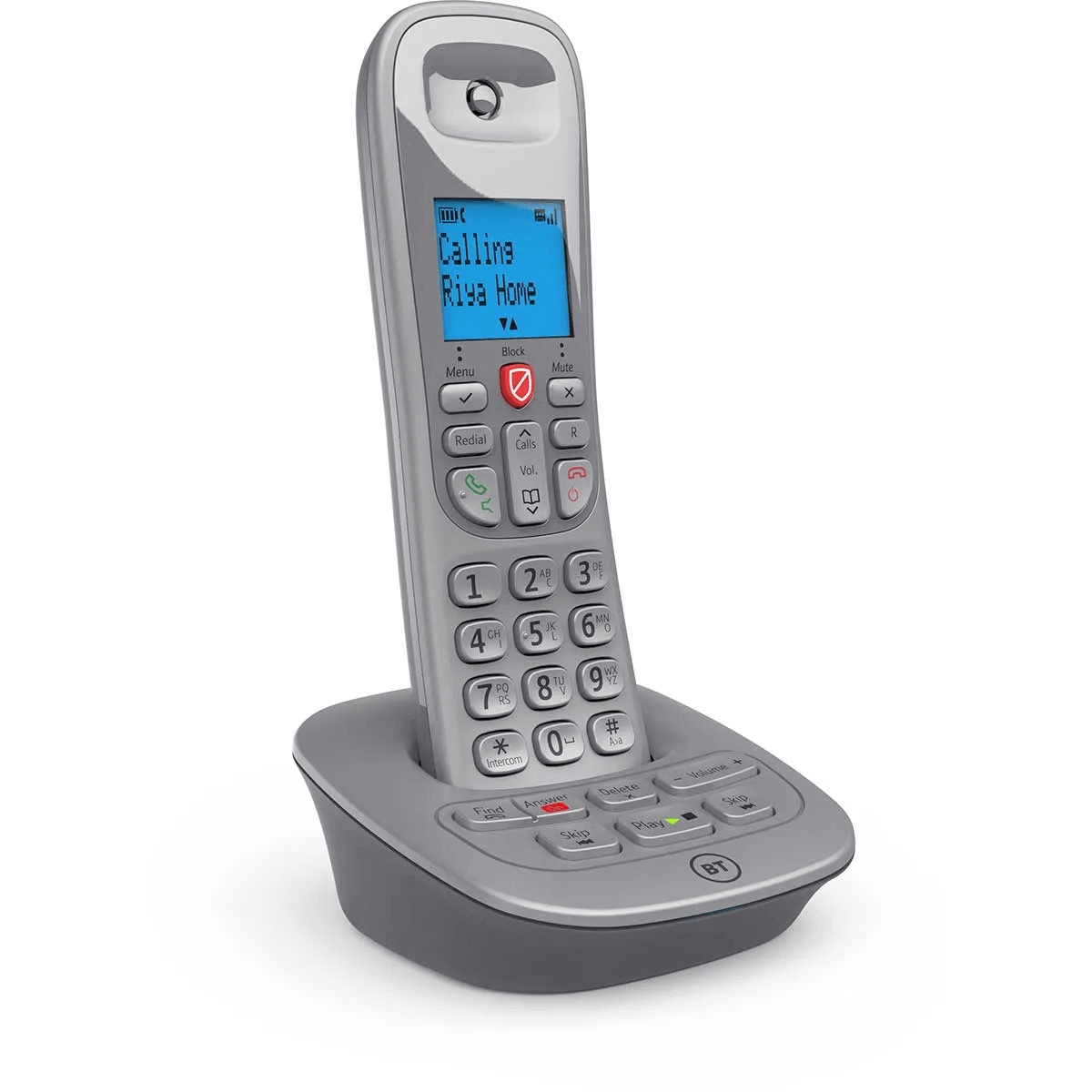

  • digital cordless telephone with answering machine
  • blocks up to 50 numbers
  • hands-free speaker
  • easy set-up
  • do not disturb mode
  • up to 60 minutes answer machine recording time
  • save up to 100 contacts
  • up to 12 hours talk and 120 hours standby time
  • greater call control with options to block calls by specific numbers *
  • blue Backlit screen
  • batteries Requried: 2 x AAA NiMH
  • dimensions: D 5.5 x W 11.0 x H 17.0cm
  • colour: Silver
BT 5960
