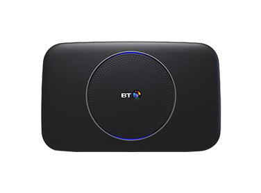

  1. Start by making sure you've connected your new Smart Hub. You can make sure everything is set up correctly by following the instructions in Connecting and setting up your BT Hub
  2. Next, check the light on the front of your BT Hub.
  3. You should have a steady blue light. If not, it could indicate a problem with your broadband service.
    Find out more about what the lights mean and what to do.
    Please note: The Smart Hub light turns purple when your broadband is down and you are connected to the EE mobile network via Hybrid Connect. When this happens, your Digital Voice service won't work. If you need to make an emergency call, you will need to use your mobile.
  4. If you have a steady blue light, check that you can access the internet by trying a web page using one of your connected devices.
  5. If you can access the web page, please move on to step 2 - check handsets.
    If you can't access the web page, have a look at BT Broadband connection problems
