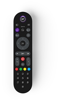

Pairing your EE TV Box Pro remote with your TV
EE TV F1 remote control
The EE TV Box Pro remote should connect to most TVs automatically.
If yours does not pair, you can reset your remote by holding down the Home and 9 buttons until the light on your remote flashes.
If resetting your remote does not work, you will need to use your TV remote and EE TV remote separately.
