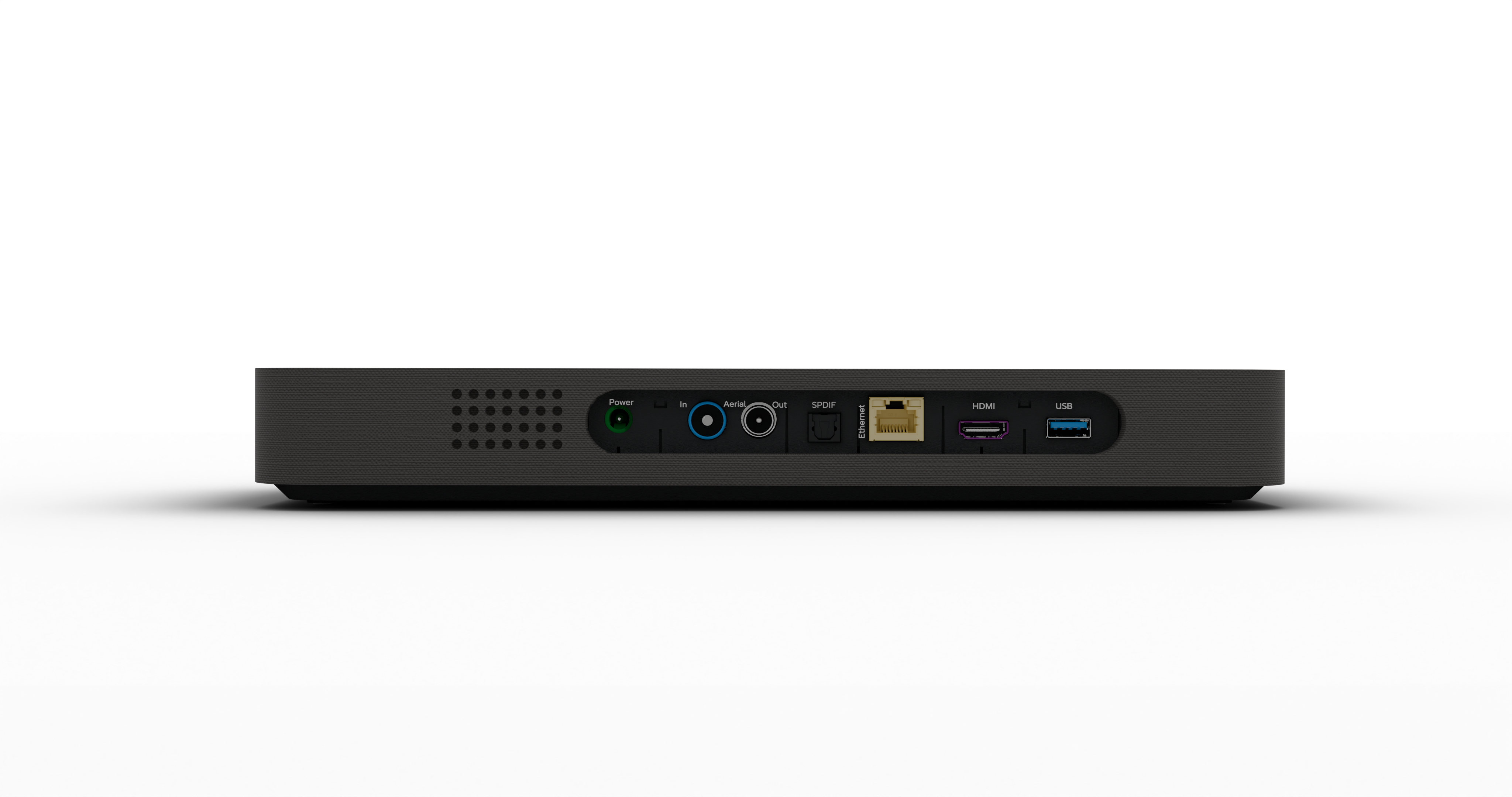

Physical description of your device
Image of back of the TV Box zoomed-in on the ports/connectors. Description of each port follows listed from left to right when looking at the back of the Box.
Rear of the TV Box Pro showing the ports.
A small round hole. The power supply cable plugs into.
Power connector (green)
A round hole with a pin in the middle.
Aerial In (blue) –  this is where you plug your aerial cable (not supplied) from the wall
A round hole with a pin in the middle. Slightly smaller than the Aerial In connector.
Aerial Out (grey) – if you want to share your TV aerial input signal with another device (cable not supplied)
Small, square port with a springy flap that moves slightly when touched.
Digital Audio Out (SPDIF) - use for connecting to some surround sound kits.
A rectangle connector. Standard Ethernet shape.
Ethernet (yellow) – if not using Wi-Fi, connect to your Hub using the cable provided.
A flat, wide rectangle connector with bottom corners slightly angled. Standard HDMI shape.
HDMI (purple) – connect to your TV using the cable provided.
A rectangle connector. Standard USB shape.
USB – for connecting some accessibility devices, for example, a keyboard.

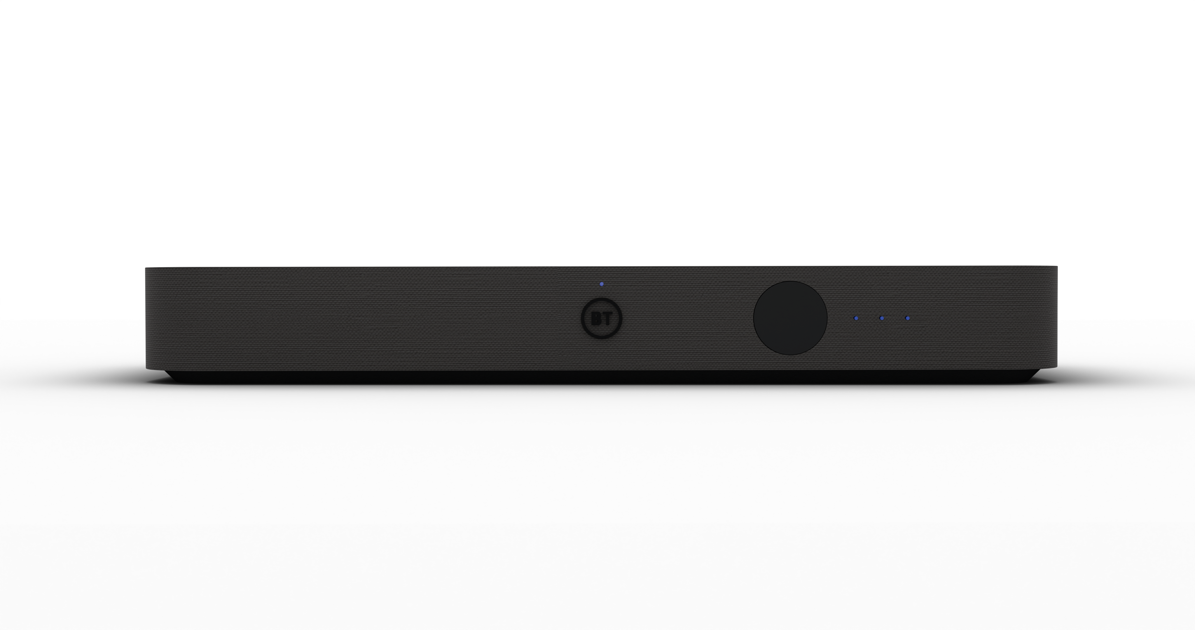

TV Box Pro buttons
Round button in the middle of the front of the TV Box with the letters BT on.
On/Off button.

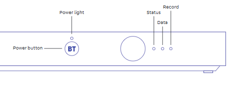

Lights on your TV Box Pro
front of TV Box Edge showing location of lights. From left to right: Power button , Power light ,Status light , Data light, Record light.
Box on
Power
Blue
Status
Off
Data
Off
Record
Off
Box on recording
Power
Blue
Status
Off
Data
Off
Record
Red
Box in standby
Power
Off
Status
Off
Data
Off
Record
Off
Box in standby, recording
Power
Off
Status
Off
Data
Off
Record
Red
Power
Status
Data
Record
Box on
Blue
Off
Off
Off
Box on recording
Blue
Off
Off
Red
Box in standby
Off
Off
Off
Off
Off
Off
Off
Red
