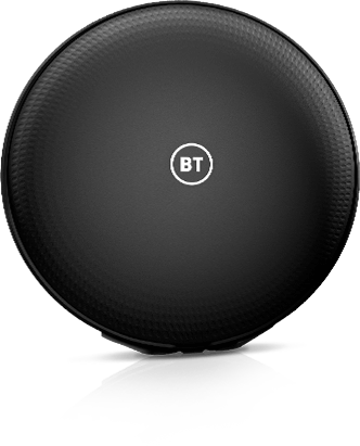

image of WiFi disc. Remove protection sleeve before setting up
Complete Wi-Fi Disc

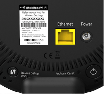

Image of back of the Hub showing the ports/connectors. Description of each port follows listed from right to left when looking at the back of the Hub.
Ethernet (1 port) – connects to your devices.
Phone port – connects a landline phone to Digital Phone service.
Device set up (WPS) button – connecting devices wirelessly.
Factory Reset button: reset to factory default settings.
Power connector
