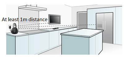

    Extra checks for a cordless phone:
    1. Check that the base is away from other electrical or electronic equipment. For example away from TVs, computers, microwaves, mobile phones, modems or routers. Ideally the base should be at least one metre away to avoid possible interference
    2. Check the base is away from large metal items such as fridges, freezers and microwave ovens
