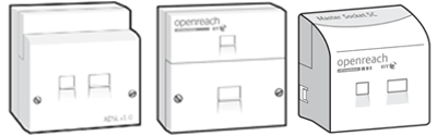

If your master socket has one socket:
Master socket with one socket
You must use a microfilter for every phone socket in your home with any phone or broadband equipment plugged in (including your Hub, phones, answer machines, digital TV boxes, and alarm systems).

If your master socket has two sockets, like this:
Master socket with two sockets

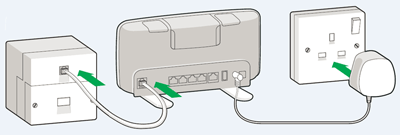

You must always plug your Hub into the broadband connection on your master socket. If you plug it into a phone socket or extension, it just won't work.
You don't need microfilters - not for your Hub or any other devices connected to phone sockets or extensions.

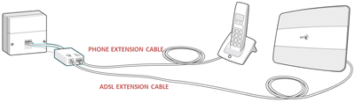

Scenario 2: Set-up where the phone is connected near the master socket and the Hub is located further away using an ADSL extension cable. Remember - using extension cables can affect your connection.
Microfilter set-up with extension sockets

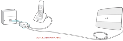

Scenario 3: Set-up where the phone and the Hub are located far away from the master socket.
Microfilter set-up with Hub on extension lead
