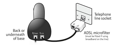

  1. Make sure that you're using the line cord that came with the phone as a different cord may not be suitable
  2. Check that both ends of the line cord are securely connected
  3. Check both ends are securely connected

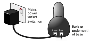

  4. Check that both ends of the power adapter are securely plugged in
  5. Make sure the power adapter is plugged into a working primary socket and the power is switched on
  6. Check power adapter is plugged into a working mains socket and the power's on

  14. If you’ve got broadband, you may need to use a microfilter to stop the broadband interfering with your phone service. Find out more at Why do I need ADSL filters (microfilters) and where do they go? You can buy microfilters from www.bt.com/shop.
