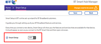

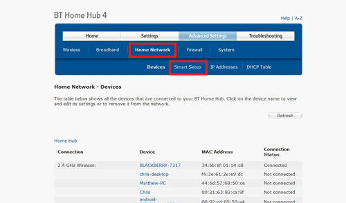

Turn Smart Setup on or off

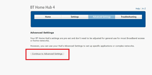

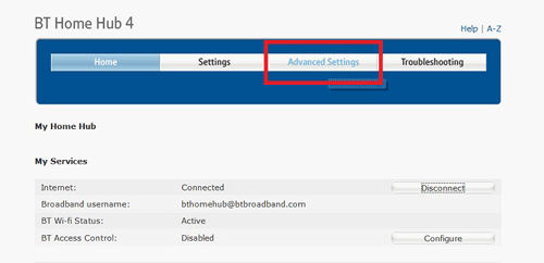

  1. Connect a device to your Hub (Wi-Fi or cable).
  2. Open a web browser.

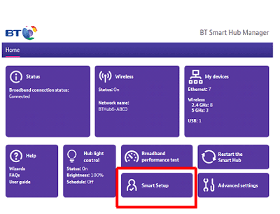

  3. Type 192.168.1.254 into the address bar.
  4. Enter your admin password
    You’ll find this on the back of your Hub.

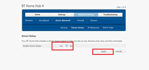

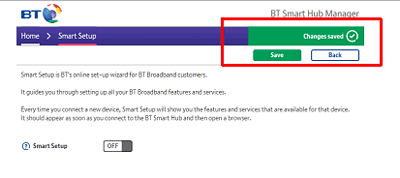

  5. Go to Smart Setup.
  6. Select On or Off.
  7. Select Save.

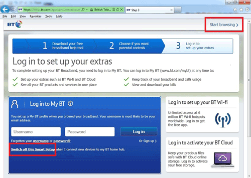

Skip Smart Setup on a device
  1. Wait until you reach the login step.
  2. Select Start browsing (top right).
You can’t skip the first few steps.
