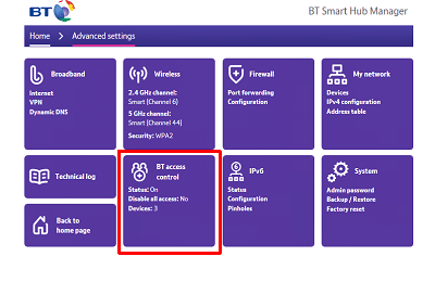

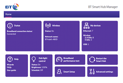

  1. Open a new web browser on your connected device and type 192.168.1.254 into the address bar. This will open the Hub Manager.
  2. Select Advanced Settings.
  3. Select BT access control.
  4. Enter the admin password. Unless you've previously changed it, you'll find the default password on your Hub settings card on the back of your Hub. If you have changed it and now forgotten it, you can use the password override feature to set up a new password without losing all your personal Hub settings and configuration.
  5. Select the device you want to apply access controls to and select Set.

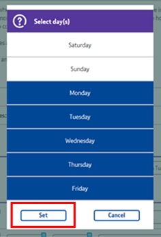

  8. Choose the days you want access controls and select Set.

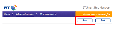

  10. Once you've made your changes, select Save.
