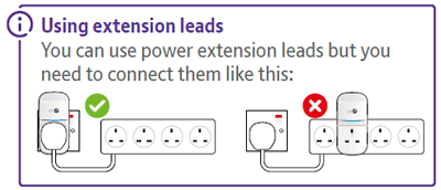

They also have a power socket on the front, so you don't lose a plug socket on your wall. The Connectors must be plugged directly into the wall socket, and not into an extension lead. We recommend you then use this socket to plug in any extension leads, or your BT TV box itself.

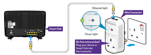

Connecting the first Mini Connector
  1. Plug one end of the Ethernet cable into any Ethernet port on your Hub
  2. Plug the other end into one of the Ethernet ports on the top of the first Mini Connector
  3. Plug the Mini Connector directly into a power socket on the wall and switch on. The Power and Ethernet lights will come on

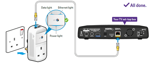

Connecting the other Mini Connector
  1. Plug one end of the other Ethernet cable into the Ethernet port on your TV box
  2. Plug the other end into one of the Ethernet ports on the second Mini Connector
  3. Plug the Connector into a power socket on the wall and switch on. the Power and Ethernet lights will come on
  4. With a couple of minutes, the Data light on both Connectors will come on

Using extension leads
BT Mini Connectors
