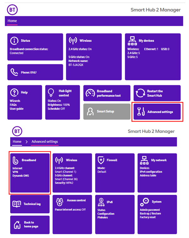

  2. Access the Hub Manager by typing 192.168.1.254 into a web browser and press go
  3. Select Advanced Settings, then Broadband (expand image)
  4. Advanced Settings, then Broadband buttons highlighted

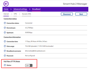

  6. You’ll see an option labelled Full Fibre (FTTP Mode) change the slider from OFF to ON, select Yes to the pop-up to confirm the changes.
    Change slider to Full Fibre (FTTP mode)
  7. Tap Save at the top of the page.

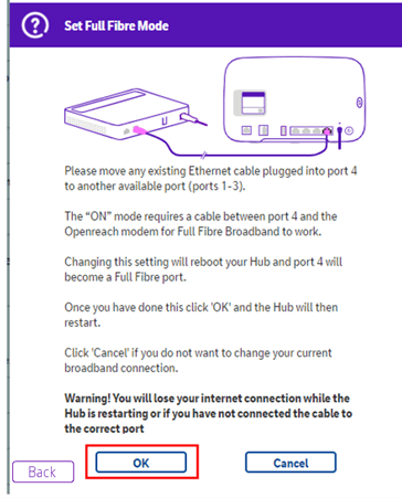

  8. Follow the final steps shown in the pop-up and allow your router time to restart (picture on
    page 3)
    Select OK to set Full Fibre mode

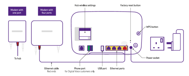

Here's how the Smart Hub 2 should be set up when using Full Fibre broadband.
Your Openreach modem plugs in to the red port shown which will either be labelled WAN or Port 4.
