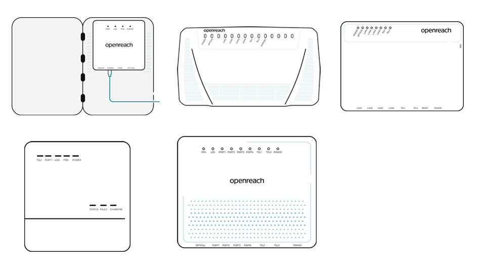

Set up Battery Back Up / Battery Back Up Plus for your Openreach modem
With Full Fibre Broadband, you will need to connect your BBU to the Openreach modem to keep that modem also powered during any power outage. If you have a Battery Back Up (the black one) we'll send you 2 devices. However, the BBU Plus can power both the fibre modem and your Hub as long as they are within 2 metres of your Battery Back Up Plus.
Follow these steps to set up a second Battery Back Up or your Battery Back Up Plus for your Openreach modem:
  1. Unplug your fibre box’s existing power cable and keep it safe in case you need it in future.
  2. Connect Battery Back Up/Plus using the plug marked ONT with the Y cable supplied with Battery Back Up/Plus.
  3. The fibre modem lights should show green.
  4. The battery takes 6 hours to charge fully.
If you have Battery Back Up Plus, you won’t need a second device unless your Hub is more than 2 metres from the fibre box. If you can, move your Hub closer to the Openreach modem.
Contact us if you need a second Battery Back Up Plus.
