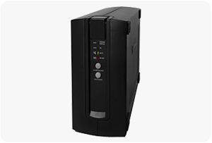

Battery Back Up lights and sounds
You might have Battery Back Up (black), or Battery Back Up Plus (white).
Battery Back Up
Lights
System Status: Green light
Battery Back Up is working normally.
DC: Green light
The battery is supplying power. When it reaches 45% charge, the light will flash, and the alarm will beep 4 times per minute.
Mute: Orange light flashing
The Battery Back Up alarm is turned off.
Press and hold the Alarm Silence button for a second to turn the volume on or off. The light will flash to confirm the change.
If you turn the volume off, the alarm will be silent for 24 hours.
Mute: Orange light solid
Press and hold the Alarm Silence button for 15 seconds until you hear 2 beeps to turn the volume on or off. The light will stay lit to confirm the change.
This alarm will stay off until you press and hold the Alarm Silence button for another 15 seconds.
Battery: Red light
The battery needs to be replaced or is missing.
The alarm will beep once every 15 minutes.
Sounds
Battery Back Up beeping
Check Battery Back Up hasn't been disconnected from the mains power.
If it continues to beep and you also have a red light, contact us so we can send you a replacement device.
If it starts to beep during a power cut, you'll still have at least an hour to make calls.
Lights
White light
Battery Back Up Plus is working normally.
Green light
Battery Back Up Plus is powering your equipment due to a power cut.
You don’t need to do anything.
Flashing green light
Battery Back Up Plus is in hibernation mode. It has 25% of a full charge left and saves this for when needed.
Press the button to use the 25% charge when you need it.
Red light
Internal fault. Contact us.
Sounds
2 short tones
1 long tone
Battery Back Up Plus is in hibernation mode. It has 25% of its charge left and is saving this for when you need it.
1 long tone
Battery empty.
Charge your Battery Back Up Plus.

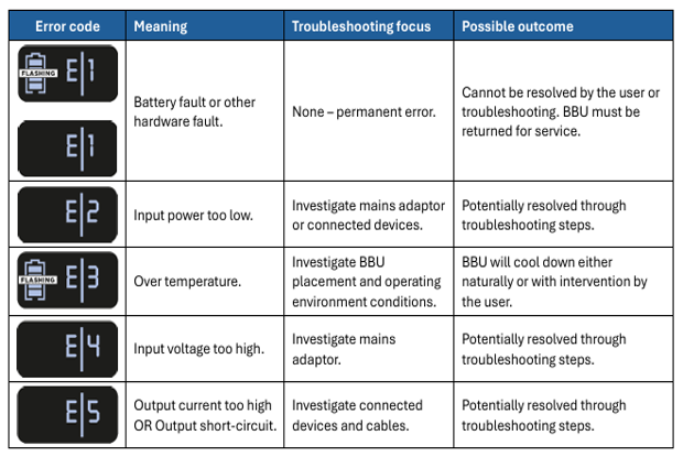

If your Battery Backup Unit (BBU) displays an error code, use the table below to see what the code means and the checks you can carry out.
