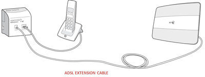

Scenario 2: Set-up where the phone is connected near the primary socket and the Hub is located further away using an ADSL extension cable. Remember - using extension cables can affect your connection.
Microfilter set-up with extension sockets

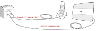

Scenario 3: Set-up where the phone and the Hub are located far away from the primary socket.
Microfilter set-up with Hub on extension lead

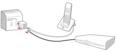

Scenario 4: Scenario showing how to connect a third-party set top box that needs a phone connection. The TV box connects to the phone part of the microfilter via a splitter. The phone connects to the other port of the splitter.
Microfilter set-up with phone on extension lead
